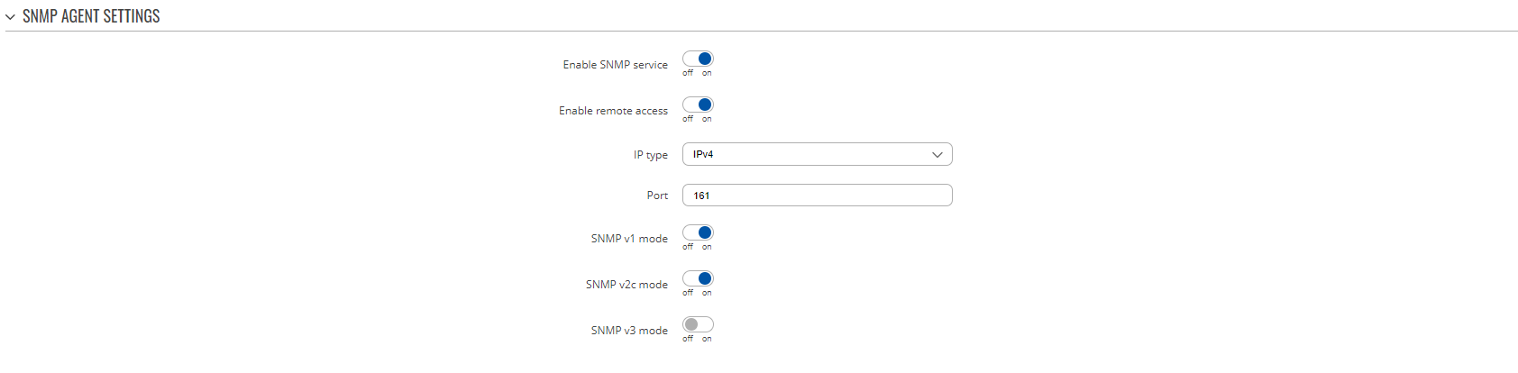

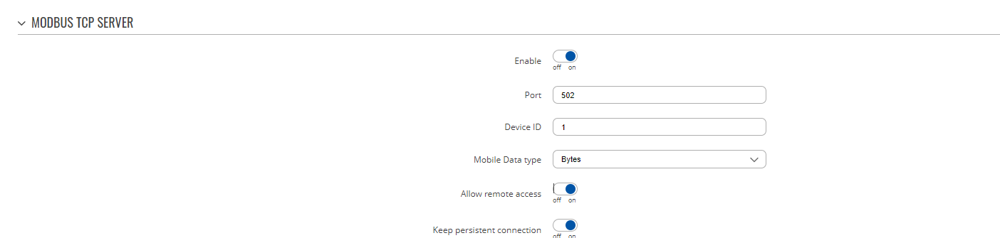

I’ve tried two solutions to get GPS data - Modbus TCP Server and SNMP. Everything works great when I’am connected to LAN port of Router, but if i need to reach Modbus TCP Server or SNMP through my SIM Card IP - devices refuses connection in both solutions. Of course in both configurations, i’ve enabled Remote Access.

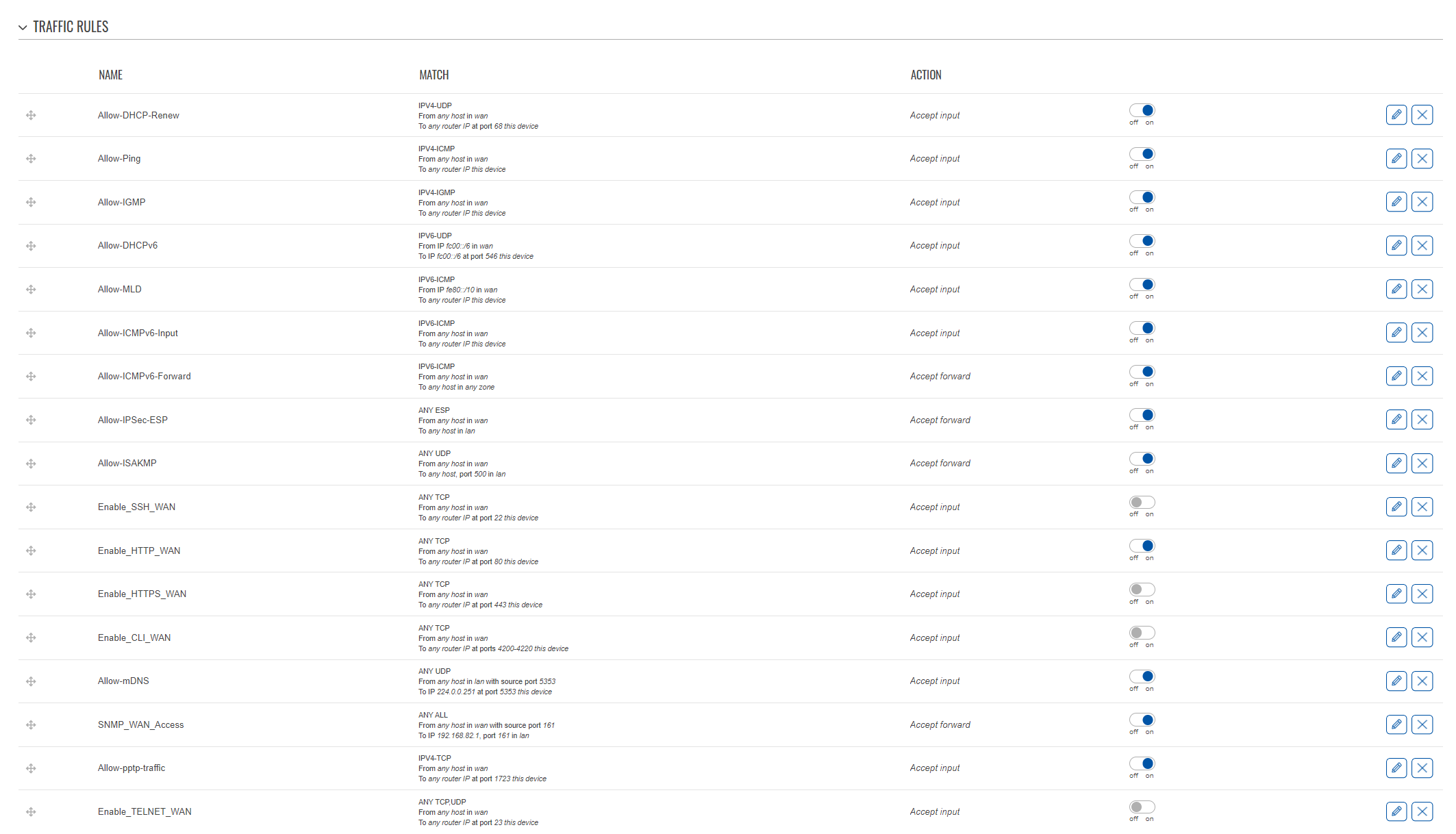

  • Screenshot of the Network → Firewall → Traffic rules (in particular the last half of the page).
From the current information it seems like everything is configured correctly, so the main suspects currently are:
  • Missing firewall rules;
  • Carrier blocking such packets;
Hello, Thank you for fast answer. Screens below:

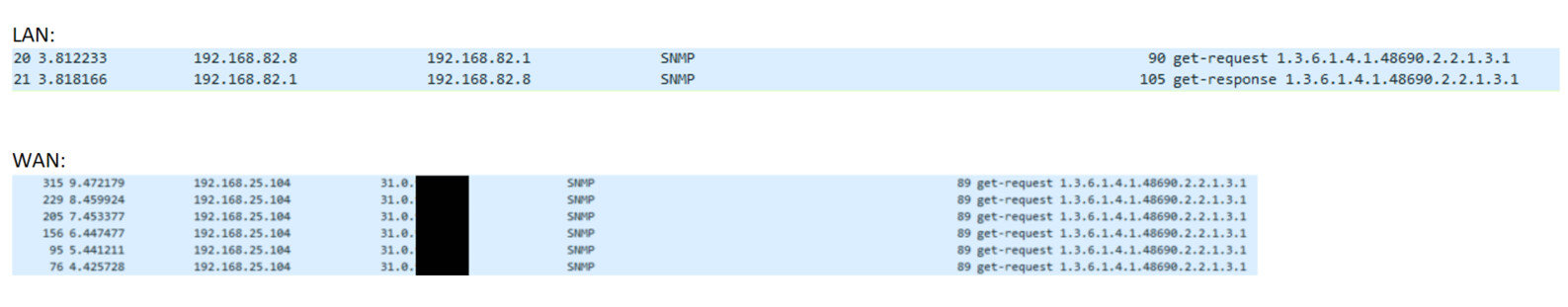

Additionally, below is SNMP tracking on Wireshark :
It seems like the issue is with the firewall rule. Please edit it to be 161 as the destination port, not the source port.
I’ve tested this with 07.05.4, but the rule was created successfully, not sure why it was created this way in your case.
Let me know if this helps!
I think I’ve added it manually (just to try everything).
Below the screen with updated rule:
And the problem is the same. Sending request, but there is no response.

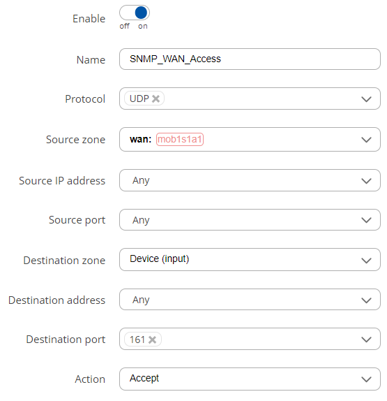

Another issue, the source zone should be WAN (which is correct), but the destination zone should be Device (input). The rule should look like so:
Now it works ! Thank you for your reply. Destination address must be Any, not with specified IP - that was a problem.
Thank you again and regards.
