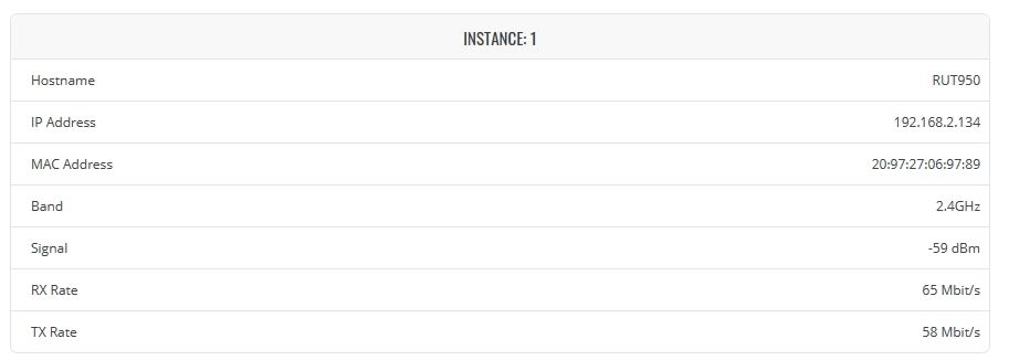

RUT2 ip is 192.168.5.1. RUT1 ip is 192.168.2.1. The Wifi connection ip is 192.168.2.134:
I would like to access RUT2 WebUi from a pc connected (ip 192.168.2.100) to RUT1 but not finding a solution.
