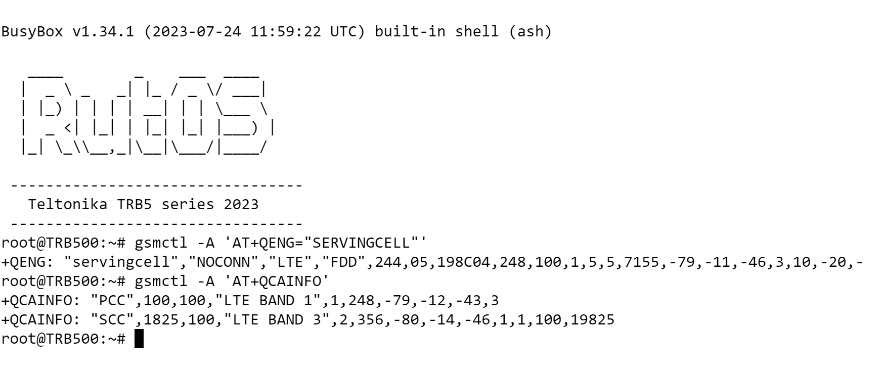

Yea, it did not work
Could you also post the output of these commands on both DNA and Elisa (if both SIMs are available): 5G not working on TRB500 - #4 by Daumantas
