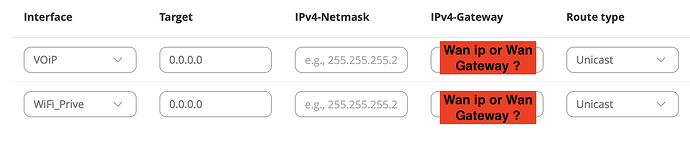

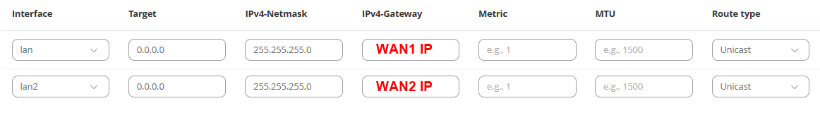

Yes, it is possible to achieve your desired setup simply by adding static routes with the correct VLAN interfaces and gateways specified. Please refer to the screenshot below for an example configuration.
If you need further guidance, feel free to reach out, and we’ll be happy to assist you.

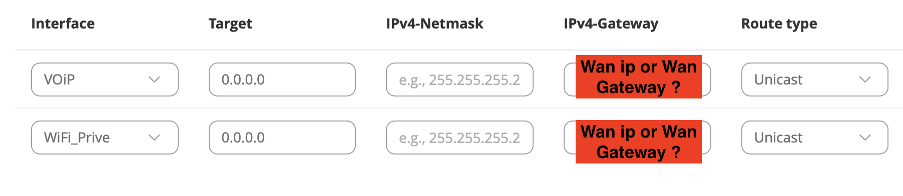

Hello thanks for you’re help but that doesn’t work :frowning:
i’ve try with wan ip fixe and wan gateway that doesn’t work
Thank you for your update and for providing the screenshots.
From the screenshot, it seems that the netmask fields are empty. Could you try specifying the correct netmask, e.g., 255.255.255.0?
Alternatively, you can achieve your desired setup by configuring 2 Load Balancing rules as described in the wiki example available here. In this configuration, you need to:
  1. Specify the correct VLAN network source IP.
  2. Define the destination IP addresses.
  3. Assign the appropriate policies for each rule.
I hope this example helps you achieve your desired setup. If you have any questions or need further assistance, please don’t hesitate to reach out.
